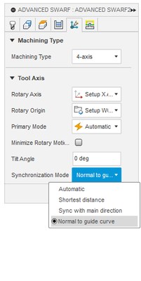

Alright, I am finally revisiting this project and I can't seem to figure out how to get it to not make round parts... doesn't seem to want to do flat surfaces very well. what am I missing? I believe I have fixed the WCS and orientated it correctly but not 100% I've attached the latest file.
a.laasW8M6T
Hi
Have a look at this video and file
I also did figure how to get advanced swarf to machine the face, I needed to set the synchronization mode correctly
