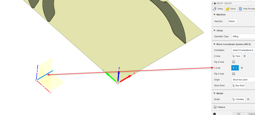

I am receiving this error :
Warning: One or more passes were discarded due to linking constraints.
Warning: No passes to link.
with this model
https://a360.co/2O5R0Jk
If I remove any lead in / out , it will generate fine. I am experiencing this error after a recent update. I have been utilizing the plasma tool path for some time and have experienced this error when trying to cut an inside object that is too small to have a lead in or out, can anyone shed some light on this? thanks

Well this is interesting...
If I align the WCS orientation to be like this:
I get a toolpath on all the parts:
Will that work for you? Aligning it the other way fails. I'll get a ticket opened on this issue ASAP
Oh, I selected the Y axis of the origin triad:
I've created CAM-23249 to track this issue, I will post back if there are any questions or when we have a fix for this. I do apologize for the inconvenience of this

Thank you, I will try your work around. It boggeled me for quite a while. I
ended up copying the dxfs and creating a new layout ect,

seth.madore
Pretty much your only option is to duplicate the toolpath and select only that one entity left over. Turn off lead/in-out and hope for the best?
