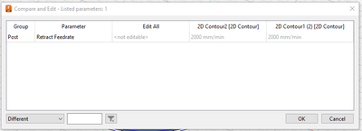

This morning I update to latest version: Fusion 360 2.0.17244 x86_64.
Trying to create some new CAM operations from templates I'm getting the following error message:
and when I press OK the operation dialog closes.
Then in the operations browser the red diamond appears next to the operation with the following error:
Since I'm not using the Tool Orientation configuration , I believe this is a bug in the new Fusion 360 version.
Yesterday it worked OK on the previous version.
After recreating the operation from scratch, it works without problem.
And when I compared both operations not differences are reported related to Tool Orientation settings:
The same situation happened with other operation (2D pocket) I have in my templates.
I also tried with some other design, with the same error message result.  But re-generating previously generated operations from stored designs worked well.
Does this happen to someone else running the Personal licence of Fusion 360?
Should I rebuild all operations in templates?

Message 2 of 10
seth.madore
There is a bug currently where some templated toolpaths are recognizing that Tool Orientation has been turned on (with no alignment set). I thought this was addressed in a hotfix a while ago, but apparently I'm mistaken.
If you can create a new 3D Contour toolpath, please do so and overwrite your template toolpath.
