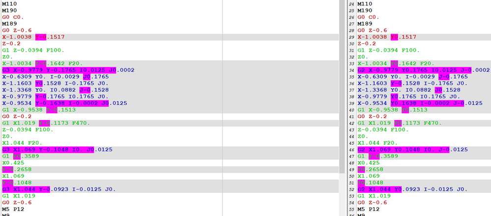

Hmm. This is odd; your post and the more recent posts do not reverse the AC axis. However, I have an r44035 that I've been working on that DOES. I did a file compare with the r44035 from the library and aside from my cosmetic changes, it's identical. But.....it flips the axis. I'm going to have to run this by the post developer and figure out what's going on.
I'm happy to share that post with you, perhaps you can migrate your changes over to it?
Differences between AC on/off:

I was chatting with a couple of the post developers, and they clued me into what was going on; Invert A/C has no effect on Polar milling, which is why nothing was changing with the stock posts, but WAS changing with my own post; my post changed from polar to non-polar as I allowed a -10mm below X motion.
