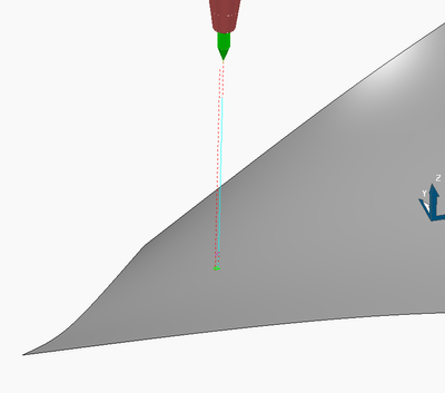

Is there a way to do a mirrored number projected onto a sloped surface in Fusion? Example below.

You have an option on the text dialog to mirror the text. Fusion also has some single line shx fonts included, they are at the top of the font list.

Thank you sir. I don't know how I missed that. Right in front of my face.
