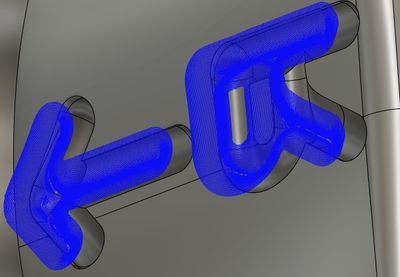

I have some letters Im milling into some molds there pretty tricky because they are on a angled surface and would like them deeper so when my parts are cast the letters have more punch. Can I move a tool path in this case I would like to move in the X and Z by maybe .015 - .02, possible?

If you're using the Engrave toolpath, there's not much you can do other than edit the Design to reflect this.
With other toolpaths, you could use a negative stock to leave, but that would apply to X/Y and Z. Could you share a snapshot of the area and toolpath in question?

Either set the g54 off of stock instead of the part, or do a Linear pattern, .02 distance, disable "keep original"

Im not using engrave, here is a screenshot as you can see it's milled pocket geometry and the surface its booleaned into is very steep.
Now here is another piece of the puzzle and 2nd question.  In my prototype mold, I cut this with a 1/16 ball end mill but because the cutter has to go so deep there needed to be a lot of stick out on the tool and it's just not practical to machine 40 molds like this. To much room for error and the holder nut hits the side wall.  I even bought a long-reach ER 11 and thought that was the ticket BUT it still hits one of the side walls.
SO IF i could find a nice ridged long shank tapered tool from say 3/16 shank to a 1/16 ball with very little DOC i think i would resolve all these issues with just having the right cutter. Ive looked at Harvey and Im trying not to spend 150.00 on a single cutter and get into extremely specialized tooling if I can help it.  Im on a Tormach 1100M.
Can you offer any input on other tooling sources for what I describe? A 2-inch overall tool is what I need.

linear pattern?  How? can you pattern a tool path and wouldent your only option be to do this in design? I dont see anywhere in CAM to do this?
seth.madore
Right click on the toolpath(s) and select "Add to New Pattern". However, this only gives you two axis of direction, but that would be enough to get you an X and a Z

I tried it, EXACTLY what I needed.  I think this will work, but finding the right tool is the better option.
