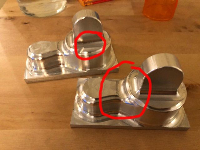

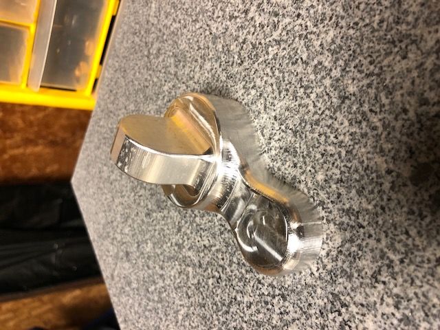

So I did the CAM on this part and did a test run (see image 0263), it came out great. I adjusted the CAM and changed the tool height IRL and then after rerun I am getting tool gouging (see photos 75, 76). I've measured and remeasured the tool in real life, the tool length in the control (Mach3) tool table is correct within +/- .0005" which is the resolution of my measurement tooling. I even reprogrammed the tool number in Fusion and then entered the tool as new in the tool table thinking I had to have messed up the phsical tool height and that's where the issue was, after running a second part with this new tool # I got exactly the same result.
All I can think of is that my maximum fine step down is too large on my adaptive clearing operation and as a result material is left behind. That said, I am using a horizontal operation on the flat surfaces before I run the contour with the ball end mill that is gouging. So the material heights should be good. The simulation in the screencast doesn't show the gouging I am getting in real life. With the horizontal op I moved the Top Height (stock top) down .015" as to avoid the the very top of the part so I can reference it in later operations.
I've been messing with this for a week now and am not making any progress, some fresh eyes I think will help.

One thing looking at your 3d contour tool path is you have the ramp set to 90 in/min and your cut is only 30 in/pm. The green lines between each level will be done at 90 in/min so might be a problem. Not really sure what your looking at from from the pictures. Also use the photo option to embed images so wee don't have to download, I generally don't bother with thread if the pictures are attached and you will get more help if they're embedded. Wish AutoDesk would hurry up and fix the forum!

If you compare to the photo below you see that the contour with the ball end doesn't dip below the horizontal surface. In the photo above it goes to a significantly lower height. So either the horizontal op is high or the contour is low.

Checking the toolpath in NC Corrector it shows the horizontal toolpath in that area is at -1.3 and the 3d contour is also -1.3 so the problem's not in the g code. You can download NC Corrector here and check. Do the tools still match the library when you've finished cutting?
