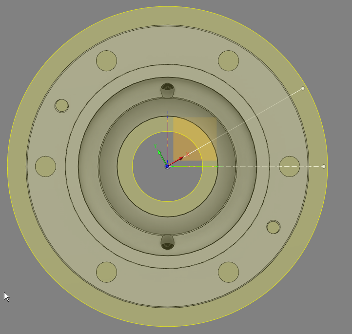

just updated now my toolpaths are dirty and wont regenerate can you guys please find this bug
360 Views
HughesTooling
I was just about to post what's below but thought I'd try something first. I found if I opened the setup unselected Spun Profile then reselected Spun Profile clicked OK the toolpaths generate, something flakey with spun profile I think.
It seems like Spun Profile is not working all the time. I found drawing a line at 30° and aligning the X axis in the setups got the toolpaths working again.
File's attached.

Just tested my suggestion to unselect reselect and it didn't work a second time, not good when the software doesn't do the same thing twice!

yeah i rarely have issues in milling but the turning seems very buggy
jeff.walters
Your right Mark Spun profile is a work in progress. Personally I normally do a sketch of a arbitrary point placed to it doesn’t intersect any holes or cutouts and it works every time.
Thanks Jeff, I thought you needed a line or edge for the axis to point along, didn't realise you could just pick a point you want the axis to point at.

jeff.walters
It’s the original way to avoid holes and cutouts, and it works in all 3 products. As I said I find it quick easy and works every time.
