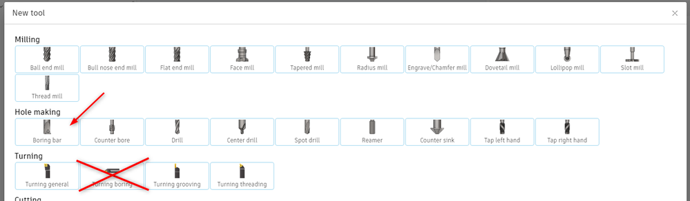

I've got a job that I'll be running an offset boring head on Omega Products 12mm Boring Head - 0.01mm Graduation - F1 12 - Range 10 – Protool Precision Tools (pr....  The question is how do I go about programming this?
I could use the reaming cycle however the insert will rub on the way back up.  On a manual mill I'd bore to the bottom of the hole, orient the spindle, jog away from hole centreline so that the boring bar clears the bore and retract in Z.  I believe most CNC's have the capabilities to do this but is it possible to program it in Fusion?  I've got quite a few parts and boring is the most practical solution for this but I'd rather not double my cycle time if I can help it.

Use the "Fine Boring - shift" cycle in the Drilling toolpath

It would seem my post processor supports this and posts the following code:
G98 G76 X0. Y76.009 Z-92.9 R1. P0. Q0.25 F90.9
I'm assuming the I just need to create a drill in the tool library with the appropriate size?

You'd actually create a Boring bar:
But, just so you know; you're going to see a solid cylinder that represents the bar in motion. With the "Shift" option, you will also likely see collisions on the retract. We haven't put a lot (any, really) of work into producing an accurate simulation with a spinning boring bar in this scenario.

Thanks.  I did try a boring bar nicked from my lathe tool library but got an error "toolpath is not supported for the given tool and settings".   Not really a huge issue though.  For this application I can live without the accurate simulation.

Yep, you want to use one that's been defined from the "Hole Making" tab, not the "Turning":
