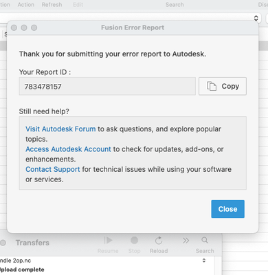

Toggled those things like you asked, ran a simulation and as soon as the simulation finished it crashed.

And again
