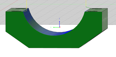

When I export this code to the HAAS it runs the tool path for the angled edges in mid air. I feel like I've tried every option in Tool Orientation but it just does the same thing! Is it something to do with the set up?

Yes, it is likely your Setup, try changing it to the position shown in the image below, everything should then rotate around that point and should work :slightly_smiling_face: :slightly_smiling_face: :slightly_smiling_face:

Thanks. I tried that and still the same result. The 4th axis vice indexes then the toolpath runs to the side of the part. It seems to be more of an issue with the Y - Axis. I've tried the et up in the centre of vice rotation and that doesn't work either. I've tried with 2d parallel and 3d face toolpaths and still the same result.

OK, few things to look at, the part/stock must be physically set up the same in Fusion and the machine. If the center of the part/stock that is aligned with the rotating center of the 4th axis as in my image then that is how it needs to be fixed in the machine.
Are you using the HAAS DWO and TCP ?
Which Post Processor ar you using Pre NGC or NGC
Which Axis is the 4th axis mounted along on the Machine ? X axis or Y axis ?
Can you upload a copy of the Post Processor that you are using ?

Yes, the WCS is replicated with the G54 in the machine. I’m using the HAAS VF-1 with the HRT160 (5th axis vice fitted) 4th axis running along the X-axis. Post processing using HAAS pre NGC 4th axis. I’m back at home now so don’t have access to the code but it’s on the file I put on the original post.

Try the attached file, run the simulation first and then generate the code, it should work as long as the piece of stock is setup exactly as the stock in the Fusion file, with the bottom center line aligned with the center of the 4th axis.

@engineguy I have tried this but can try again. The centre of the stock Z not the bottom is in the centre of the vice. The only file I can see that's attached is the photo....

This is the actual centre of rotation. Should the set up be mill or mill turn?

Apologies, forgot to attach the file, here it is again, now it is set to the middle of the Stock as in your image, if that is how it is actually fixed in the machine then this attempt should be a lot closer :slightly_smiling_face:
Setup should be set to "Milling".

This has worked!! Thank you for all your help. What had I done wrong?

Really all that was wrong was getting the center of rotation in the correct place, it is just a matter of how the Stock is fixed to the 4th axis compared to what is set in Fusion, they have to match :slightly_smiling_face:
Originally you had the rotation point set to the top of your stock and then I did one with it set to the bottom but you did have the stock set in the 4th axis to the center of the stock so selecting that point made it work :slightly_smiling_face:

@engineguy OK, so I've figured it out! I ran your toolpaths again straight out of the model you sent and this time it machined mid air! For some reason my post processor auto checks this box "rotate A-axis the opposite direction" When I uncheck this box all the toolpaths work!!
