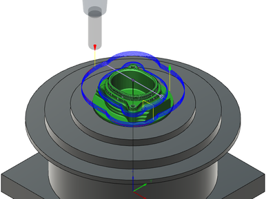

I'm getting a problem (which I've seen before) where the 3D Contour is machining the air around the tool boundary (see pictures). It doesn't matter if I select, Bounding Box, Silhouette or selection.
As writing this I realise that it goes away if I select "Rest Machining". Is this intended behaviour?

I'm pretty sure the answer is you have unchecked the contact only box on the geometry tab.

That seems to fix it! Thanks, it has frustrated me  a few times in the past so good to know how to cure this.
