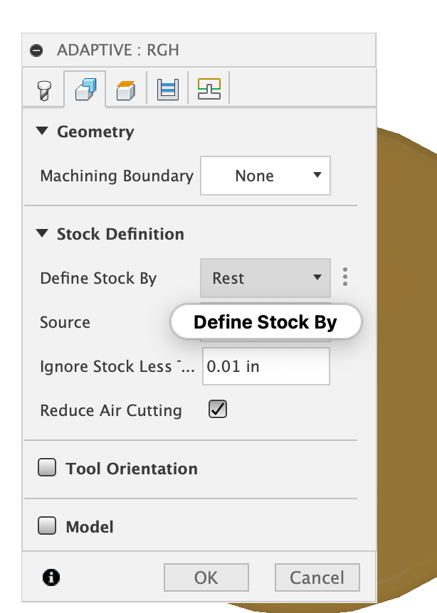

If I enable "reduce air cutting" there is no more air cutting, but it actually leaves more extra stock on one side:
Tooltips never pop up for these rest machining settings so hard to tell exactly how the new settings work. I just get the mini ones that are redundant text:
Any ideas what's going on?

Is this Insider build (or Production with Insider access)?
I think the tooltip issue is because these are "work in progress" options and the tips aren't implemented yet.
Is there anything in your Setup "selected model" that it's trying to avoid? Could you share the file here? (this does look like a bug)

It appears there's an upper limit to how many times you can have Setups with "From Preceding Setup" and "Continue Rest Machining". If we drag that Pin Op1/2 to the top of the Browser tree, we get this:
Seth Madore
seth.madore
Upon closer investigation, this does appear to be an issue with the 3D Adaptive "Rest Machining > From Previous Operations". For some reason it's picking up the "B" fixture when it calculates. Setting it to "From Setup Stock" produces a correct toolpath. I've raised this with the appropriate developer and will let you know if a ticket results from the conversation
