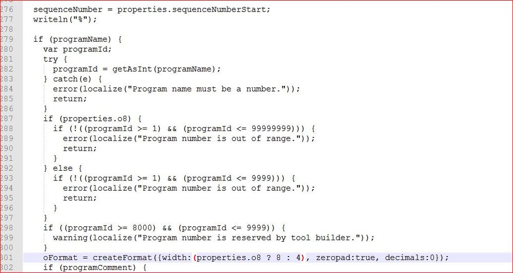

Hi, looking at your sample code it is a little different to what is normal for Fanuc 0M, I have had several 3 axis VMC Mills over the years with Fanoc 0M control and the start of the code the Program number has always been the O and then 4 digits, like this
O1001 O and 4 numbers
Your sample code is
O01 O and two numbers
Also there is usually a % sign on the first line but your sample doesn`t have this either.
If you want the Fusion Fanuc generic post to output as per your sample then you need to modify your Fanuc Post Processor.
Before making any changes make a copy of the post and save it in a folder somewhere on your PC then you can replace it in your library if it all goes wrongSmiley Happy
See the image below, look at Line 277 and you will see the % sign, if you delete it then it won`t be posted in the code.
Next look at Line 301, where you see the number 4 change it to a 2 and save, do not do a "save as" just click on "save".
Now try posting your code and the % should not be there and the number of digits after the O should be 2, if that is the error you are getting then hopefully that will work for you.
regards

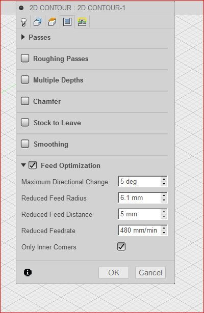

The G62/G64 is the automatic corner slowdown that you can set in your control, however it can be done in Fusion under the "Passes" tab using the "Feed Optimization" option, see image below.
Also attached is a small program I did to test the code generation, run it and see if it is close to what you are doing.
