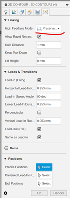

Where do I set the feed rate in the pass tab?
410 Views
matty.fuller
It's not in the Passes tab, it's under the linking tab and by default will be rapid (G0) so no feedrate is specified. You can change it to Use High Feedrate Mode (G1) and specify a feedrate.
If you're using the free/personal version of Fusion, you won't be able to output rapid moves.
Unixprocessing
I don't know how to set it to g1 mode. Can you tell me?
matty.fuller
It's the last option in that dropdown, "Always use high feed"
