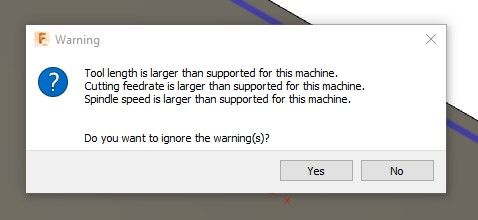

engineguy
@Anonymous
With respect, please forgive me but I am puzzled by your question, as far as I am aware the Machine Configuration actually has nothing to do with what is Posted in the G code.
It is simply a tool to use within Fusion that helps the user see if everything is correct before Posting code to send to the machine, if used correctly it will help the user make sure all is well before Posting.
For example, if you create a Machine that has a top spindle speed of say 6000rpm and you create an operation with a spindle speed of 10000rpm you will get a warning telling you the rpm is too high for the machine, just one example, same goes for cutting outside the machine limits, you will get prompts and if you override them then you get the Yellow triangle with the warnings.
Here are a few of the warnings from a Setup and Operation using a Mc Configuration that won`t support my actions, use it by all means but don`t expect it to be transferring information to the generated code, here a few example warnings I got for doing it wrong !!!!
