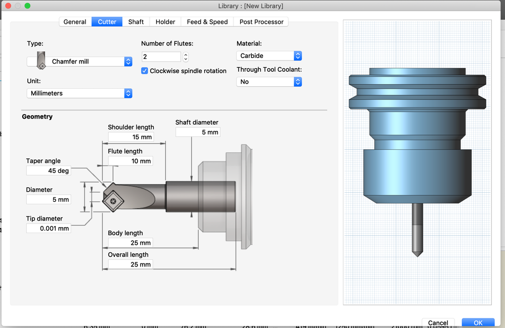

@chmed make the Vbits using the chamfer tool option in the tool libury.
The tool paths in Fusion are whatever goes it does not matter what its name is they can be used in many applications, I use them in wood all the time all you need to do is learn what they are for there are people out there that think it is all a wast haveing fancy tool paths for cutting wood what is a lot of crud.
