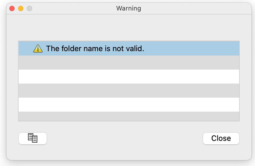

So upon hitting "Open" I just get this error:

Actually this isn't fixed anymore. Same thing. Generating a setup sheet gives me the original warning (not the error):

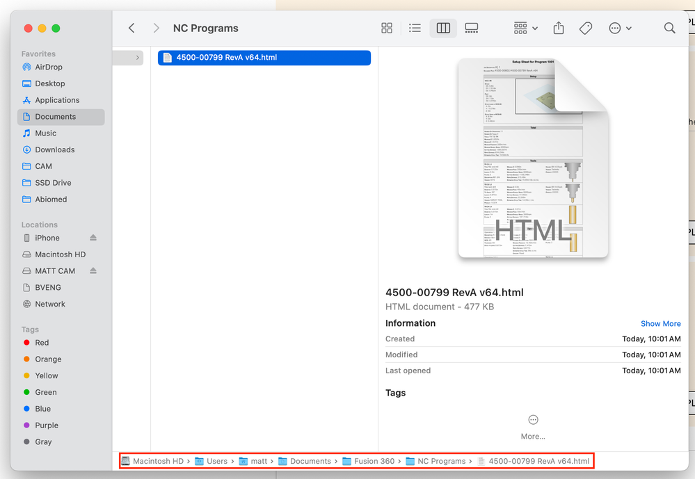

Issue resolved by manually creating the "NC Programs" and "Fusion 360" folders in my documents:
