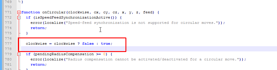

@timdrink01 I've come up with an easier way of swapping the G2s and G3s. Add this line at the beginning of the onCircular function.
  clockwise = clockwise ? false : true;
Like this.
Mark

I just realized the line of code above only reverses G3s, G2s would stay G2.
This will work.
  if(clockwise){
	  clockwise = false;
  }else{
	  clockwise = true;
Mark

I had to reverse the arcs on my lathe also.  I just replaced each test of clockwise with a !clockwise so you end up with this:
writeBlock(conditional(properties.type != "A", gAbsIncModal.format(90)), gPlaneModal.format(17), gMotionModal.format(!clockwise ? 2 : 3), xOutput.format(x), yOutput.format(y), zOutput.format(z), iOutput.format(cx - start.x, 0), jOutput.format(cy - start.y, 0), getFeed(feed));
Though I suppose Mark's way is even easier.  But could be reduced to just:
clockwise = !clockwise
Dave
