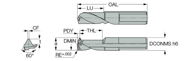

Sq_14
I need to make use of my 20mm left handed (=M4) EcoCut Multitool for outside work but i can't get Fusion to come up with a tool path in negative direction on OUTSIDE profiling.
I have the tool as a third tool number ready, spinning the other way, but If i choose OUTSIDE profiling the negative direction Box disappears and the tool path is generated and simulated with the wrong cutting edge or just works the front of the part as far as the angles allow.
What am i doing wrong here ?

that's the tool i'm using ..

I'll take a closer look later this afternoon, but I've found that you have to define multiple tools in the library to 'trick' F360 in to working with multi-function tools.
So you've got a LH Ecocut oriented in the holder with the insert on top... and you want to OD turn (M3) - is that correct?

Ok, took me a few minutes to get things figured out but I think I've got an answer for you, even if you won't like it much.
  • Go to your preferences and turn on "Turn in Negative Diameter"
  • Edit your toolpaths and you should now have a "Turn in Negative Diameter" checkbox under Edit>Mode
That sorts out everything but the OD profile toolpath.
I couldn't get the OD toolpath to work below center on your model or on mine.  I've defined my tool as a RH, so my OD cuts are in X+ (not on the far side).
The problem is that if you change the mode to OD Profiling, the "Turn in Negative" option disappears.  All of the facing and ID operations can use it, but not OD.
I think you've found an F360 bug, or  - more likely - a feature that hasn't been implemented.  OD turning below center may not have even been contemplated by the F360 programmers.
Unless someone from F360 is ready fix this right now, I think you're stuck orienting the tool 180 (if possible with the flat?), or switching to RH multi-function tools.  Orienting the tool would allow you to cut below X0 on the ID in M4, and above center on the OD (M3).
