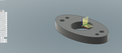

Trying to machine an ellipse and seeing step moves in part
hkenuam
728 Views
9 Replies
Message 1 of 10
hkenuam
I have a simple part that has an inner hole and ellipse shaped outer. When I machine the part I'm seeing each x/y move in part (see picture). I've tried smoothing, using R vs IJ and it some cases seems a bit better but still not acceptable.
If you look at the picture you can see the small moves (keep in mind I've gone over it a few times and you can see tool marks). But the individual steps I can't understand. I even thought maybe it's the machine but notice the hole in the center. Absolutely perfect.
Please help

Message 2 of 10
seth.madore
Could you share your file here? It's not clear from the clipped image of your browser what toolpath may have left that mark.
File > Export > Save to local folder, return to thread and attach the .f3d file in your reply

hkenuam
I think I see the problem. I exported my ellipse as a .dxf and opened it in BobCad and what you see here is what the machine is doing. The outer ellipse I added using BobCad.

Seeing the (Fusion) file would help us to determine if an old bug has popped up again, please share it if you can

hkenuam
Believe me, I left Bobcad a long long time ago. Fusion has been awesome.
Here is the file- btw, I could not include the file as an attachment.

File > Export > Save to local folder, return to thread and attach the .f3d/f3z file in your reply.
What post processor are you using?
Seth Madore
Message 7 of 10
hkenuam
Here ya go.
Thanks in advance
Message 8 of 10
seth.madore
Change your Tolerance on the 2D Contour toolpath, from .001" to .0001". Leave your Smoothing at .001".
These black dots represent toolpath points, Before and After:
Seth Madore
Message 9 of 10
seth.madore
Bulk of the resulting G-code:
N150 X5.064 Y-1.2665 Z-0.4
N155 G41 X5.0145 Y-1.217 D19
N160 G3 X4.975 Y-1.3125 I0.0955 J-0.0955
N165 G1 Y-1.3168
N170 G2 X4.7928 Y-1.9163 I-1.117 J0.0119
N175 X4.4418 Y-2.3025 I-1.2735 J0.8048
N180 X3.899 Y-2.6259 I-1.431 J1.7847
N185 X3.1067 Y-2.8642 I-1.3752 J3.1364
N190 X1.1982 Y-2.8001 I-0.808 J4.3902
N195 X0.4924 Y-2.5258 I0.8542 J3.2426
N200 X0.0201 Y-2.1818 I1.0561 J1.9464
N205 X-0.2857 Y-1.7439 I1.0182 J1.0368
N210 X-0.353 Y-1.0949 I1.0077 J0.4325
N215 X-0.0786 Y-0.5526 I1.2062 J-0.2698
N220 X0.3309 Y-0.1976 I1.3305 J-1.1213
N225 X0.9177 Y0.0868 I1.4316 J-2.2056
N230 X1.9034 Y0.2944 I1.2836 J-3.6525
N235 X3.4307 Y0.1673 I0.4026 J-4.4031
N240 X4.132 Y-0.1127 I-0.8647 J-3.1841
N245 X4.5817 Y-0.445 I-1.0703 J-1.9188
N250 X4.8855 Y-0.8808 I-1.017 J-1.0329
N255 X4.9755 Y-1.3125 I-1.045 J-0.443
N260 G1 X4.9757 Y-1.3213 F200.
Seth Madore
Message 10 of 10
hkenuam
Well, the most certainly made it much better. The rest might be feeds and speeds related. Thanks so much for the help. Fusion360 rocks!
