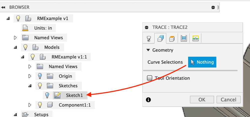

paul.clauss
Hi @eduardo_sanchez2
Thanks for posting! I like to select the entire sketch containing the font geometry from the browser tree. I hope this helps!

seth.madore
@paul.clauss  which only works when the Font is the only thing on that sketch. Sure would be nice to get window selections....   🙂

eduardo_sanchez2
Hey Guys,
Thanks a lot for the idea of the sketch selection.
Yes, it does only work if you have the fonts independently saved on a sketch, I do agree it would be nice to have window selection,
