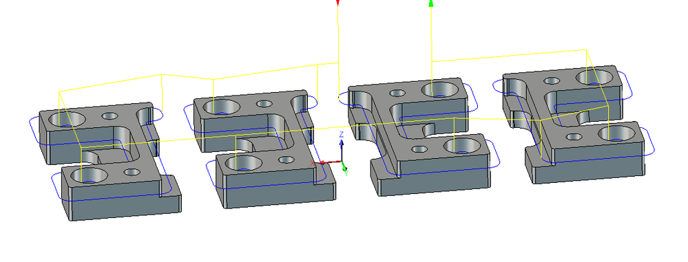

Using Windows 10; latest version of Fusion 360; I have an assembly with four parts which are just references because I'm making four of them in one mill operation.
Trying to use 2D chamfer, it will not chamfer certain areas, with no rhyme or reason. There's plenty of clearance, and the same profile chamfers on reference 1, but not reference 2 on the same part!
Here's a link to the project: https://a360.co/2H1xycN

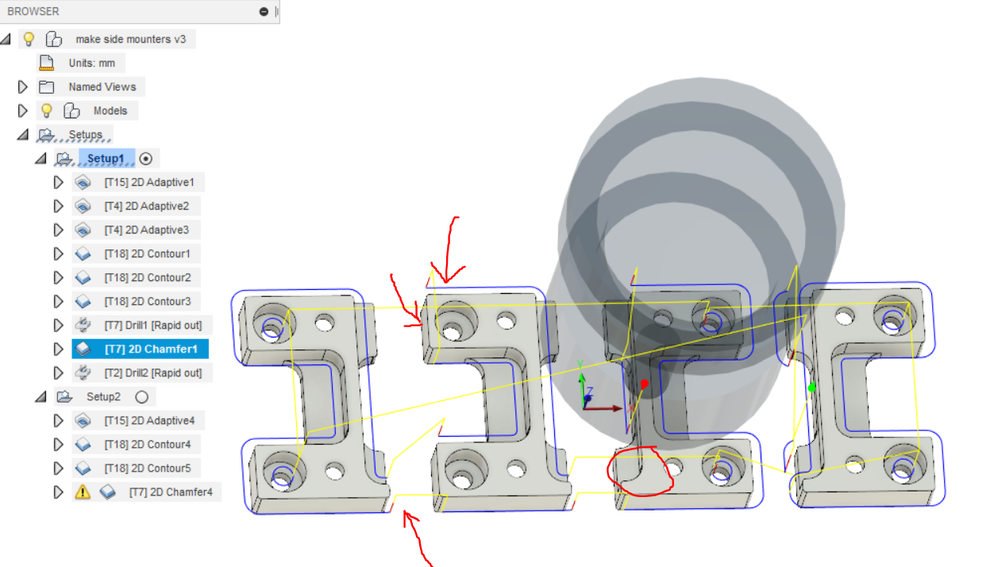

I'm using a 6.35mm 90 degree chamfer mill, a 0.2mm chamfer, a 1.6mm tip offset, and there's 7mm between the parts (with offset 1.6mm, it should only be about 4.8mm out from the part)
Especially the area with the ring around it is bizarre. The same area, with less clearance, is chamfered correctly on the rightmost part.
Here's the setup in the project:
If I were to take a super wild guess, perhaps the chamfer clearance checker doesn't correctly account for the transform of each of the references? Totally bizarre.

https://a360.co/2J1nRys
There is no problem if using 2D contour instead of chamfer.

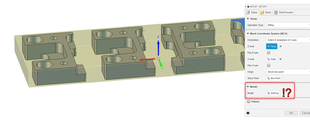

@jwatte the issue you are seeing is a carbon based error.
You never designated the Model in your setup:
Setting it correctly to include all your models will give you this:
To the point made by @Anonymous I too seldom use Chamfer, but that's mostly because it didn't even exist when I started using Fusion. When it first came out, it was super limited in what it did, but it has improved over time. I do use it often now when I have a shoulder or wall to come up against.

Thank you for the answer!
I have used Fusion for several years, and I've always thought that "None" on "Model" means "every body is the model."
Learned something new today!
