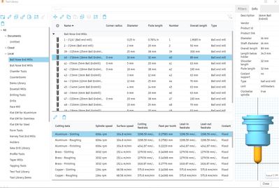

This is insane! I want to know what my SFM numbers are, but instead of giving me a whole number, fusion defaults to showing me 1 digit to the left of the decimal, and 3 digits past the decimal! Useless!
A similar thing happens with Feed per tooth, Ramp feedrate and Feed per revolution.   There is a work around, I can click in the field and arrow over to the left, but I shouldn't have to take this extra step.
I looked in the preferences and found nothing. I didn't find anything by searching online either. Surly others have this problem as well!?

engineguy
@PhilCNC2
If you set them correctly to what you want for the tool (In your image it is a "Custom" tool) then your settings under the "Cutting Data" for your tool should show for the tool/operation/material that you set, do they not transfer through for you ??

engineguy
@a.laasW8M6T
So are you saying that your Tool Libraries are being overwritten during Fusion Updates and reverting to the original default settings in the Cutting Data tab ??
It isn`t doing that here, I have tools from a couple of years ago that I have set "Presets" set for and they are all still as I set them way back 🙂 🙂

engineguy
@a.laasW8M6T
@PhilCNC2
Image below of one of my Tool Libraries, these were done months/years ago, note, it is a "Local" library so appears to never get altered by Fusion Updates 🙂
Hope this helps 🙂

a.laasW8M6T
I'm confused, this has nothing to do with the Tool Library, and all about how numbers are displayed in fields of the toolpath windows. I'm talking about modifying values in the toolpath, I use my presets a lot but sometimes I need to tweak my feeds and speeds to suit a particular setup or cutting conditions.
here's a screencast showing what I'm taking about.
https://autode.sk/3M1SCAB
