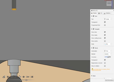

Threadmills simulate tooth-less
programming2C78B
ok here
not ok here
Please click "Accept Solution" if what I wrote solved your issue!
402 Views
seth.madore
That's likely because the pitch of your thread toolpath is greater than the pitch of your tool. This is a known bug that's being worked on as we speak.
Seth Madore
programming2C78B
yes that was it.
