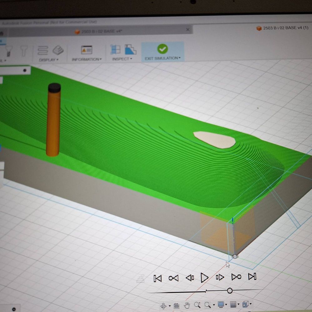

There is a problem generating the G-code. I tried simulating it in the file, and it worked fine. But when running it on the actual CNC machine, an error occurred as shown in the picture.

Have anyone help to look at my file and what wrogn with it20250507_161937.jpg20250507_162506.jpg

programming2C78B
A step file doesnt help us at all. Show us your toolpath or fusion project.
Its probably an issue of retracts or using a rapid instead of a feed.

seth.madore
Would you be able to share your Fusion file here?
File > Export > Save to local folder, return to thread and attach the .f3d/.f3z file in your reply.

What is the machine and controller? To me, it looks like some version of a "dog-leg" move that one would typically see in a Haas machine.
To prove that it is (or isn't) that issue, we can start by setting the High Feedrate Mode to "Always Use Highfeed"

artismee
Now I have found the problem on the CNC machine, the Z axis lubrication is not good, causing the drive motor to malfunction. After lubricating the axis, I opened the original file without any problems. Thanks for everyone's advice.
