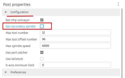

Hi @alexandrua958 ,
It seems there is an error related to the G140 line. If your machine does not have a secondary spindle, you need to disable this feature in the post property "Got Secondary spindle".
