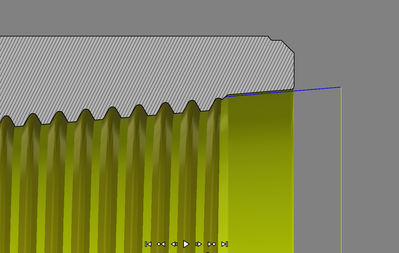

  Ok, will try to explain the easiest way I can.  Cutting a 3 1/2 IF Box,  Which is a 4 TPI .250 pitch .119 deep.  When threading it always cuts into the counterbore which It shouldn't touch the counterbore.  I moved the offset to .1 from where it is suppose to start cutting which it does look correctly except and I could be wrong, the start point as it comes in cuts a circle on the first thread then moves forward in lead.  I have done this 1000's of time on Mazak using Mazak program pulled the same numbers for my model in fusion and it still cuts into the counter bore.  I am sure the pathing is the same on pins, you j just can't see it because the pins threading starts at the begging.  Is there a way to make it thread coming in straight and then taper up from the spot it is suppose to start to the end rather than start tapering from the start of part?  Hope I explained this clear enough.  Included print if someone has the answer.

Looking at your Sketch, are you certain that all the values are correct? Your Sketch is unconstrained (all blue), so it's telling us that features haven't been defined thoroughly. Some of the dimensions you have on the sketch are not present on the PDF that you shared, so I'm curious what your source of them are 🤔
Point of clarification: the counterbore you're referring to is the front tapered bore, correct?

From what I can gather from that drawing although it doesn't have quite enough info like Seth says, you haven't modeled it correctly.
You have 5 degrees for the thread taper but from what I can see its 2"per foot taper included angle which works out to 4.73°.
I also don't see any mention of the 10degree taper in the Counterbore, that appears to be the same as the thread angle.
I have re modeled it to what I think are the correct dimensions and you can see the thread doesn't hit the counter bored area, again I don't know anything about API connections so could be completely wrong

  • Counterbore Major Diameter 4.078, you have that correct
  • Thread Pitch Diameter 3.808 at 0.625 back from the front face, Your sketch doesn't fit with that dimension
  • Thread height above pitch line 0.07
  • Thread taper is 2" per foot AND thread taper = counterbore taper according to this from ISO 10424
so 2/(arcTAN(2/12)) = 4.73116°
Video with some tips on getting a fully constrained sketch for the revolve
(view in My Videos)
File attached with corrected dimensions, I didn't realize the 3.808 was the pitch Diameter in the first one I shared

  Wanted to thank every one for the time and patience.  While I still have a lot to learn drawing up the models I worked through it.  The videos and models supplied helped 100%.
