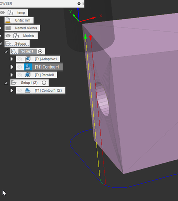

HughesTooling
@seth.madore  I've noticed sometimes 3d contour doesn't create the correct leads on bottom pass and this mesh file shows one example.
If I create 2 passes I get the leads I'd expect.
Same linking settings but one pass and there are no horizontal leads. Attached file has both OPs.
Mark
Mark Hughes
Owner, Hughes Tooling
