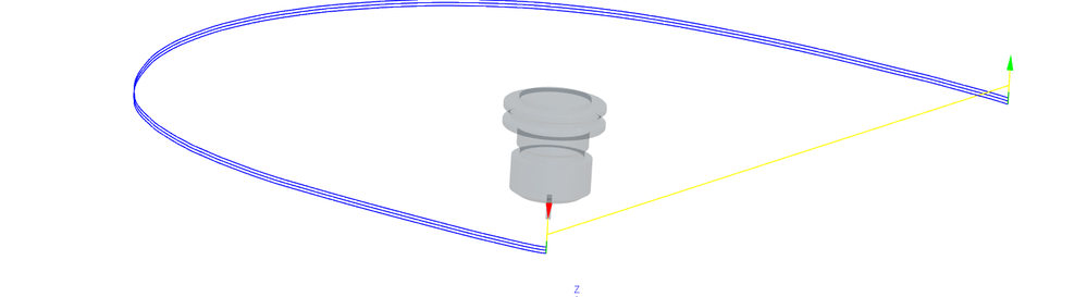

Hi, I've  been having problems with the attached file, I need to create a tool path that enter on one of the holes and exit on the other one. The part has a slight inclination at both ends, it will run a 1/8"

How true to the model are you looking to stay? Pressing the ALT key and selecting the bottom edge allows me to get this path:
But it will gouge at the drop hole. You will need to hand craft a little lead section if you want it to plunge in centered with the drop hole.
File is attached
