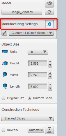

Noobie to Fusion here, and trying to learn the software for creating items to use for CNC Routing. What I am trying to do is take a 3d STL of an automobile, import it into Fusion or Fusion Slicer and slice the model from front to back in lets say 1/2 inch slices so when so laying the individual parts down on their sides to CNC can be reassembled. I am enclosing a glue up of a 2D model I created via vectors but would like to see if I can slice up a 3d model and also bring in the 2D models and add 1/2 or 3/4 inch depth to the pieces.

I'll be completely honest, this is the second time I've ever played with Slicer. Is this what you are looking for?
Things I did: When I imported it, I did make sure that "UP" was considered the Z axis. Not sure if that matters
After the import, I just select this button:
And pulled the direction this a-way:

Seth -
One last question, I don't see anywhere in Slicer to adjust the sizing of the slices (like to make them 1/2 slices, etc.) if I import these into Fusion 360 would you think the slices can get adjusted in size. Just curious, as I said just getting started with these 2 programs.

LibertyMachine
On the left side of the screen, click on the little gear I've highlighted:
Now at the bottom of your screen you will have a new panel. This is for your material setup. What size plywood are you using? Enter it here.
2018-03-20_18h33_18.pngas
Now, you will likely want to play with the actual scale of your car. Right now it thinks the car is 8" long, 2" wide. You will likely want to scale it up to a size that you want. That can also be done from the left bar, in fact you will see the fields in the top image above

Seth, Thank you very much.....
I thought you had to create a custom setting and every-time I did nothing happened.
