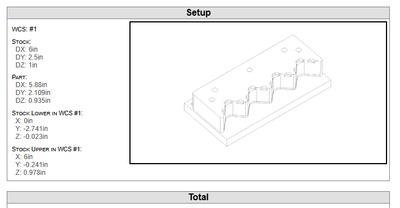

A downside of this method is that when you select an NC program, you can no longer display the material outline, therefore the material is not shown in the image on the setup sheet. Our machine operators find it helpful to display the material outline on the setup sheet.
Setup sheet image as created from an NC Program either via the Setup Sheet function or via Post using the Setup Sheet (HTML) post processor.
Setup sheet image as created from the Setup using the Setup Sheet function.
So, there are several ways to work around the inability to specify a file name, but each has a deficiency. It seems like it would be pretty easy to change the Select Folder dialog to be a Save As dialog in the Setup Sheet function of the Setup. That would make things very clean, easy, and obvious. Until then, I think I'll continue saving each setup sheet in its own folder to avoid overwriting.
