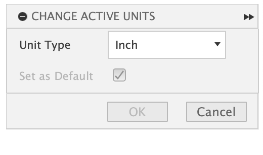

I think this is expected. In the first part of your math, you've specified the units (-.33 in) but the second part (.125) is unitless.
What do you get when you have -.33 -.125

Default units in both Design and Manufacturing are set to inches:
Screenshot 2024-06-07 at 8.38.07 AM.pngScreenshot 2024-06-07 at 8.38.11 AM.png
I'm in inch mode and it's set as the default:
Surely every number I input should be assumed to be in inches unless I specify otherwise?
Fusion specified the units. Because I'm in inch mode. I never typed "in". I would have just typed "-.33"
.325, treats second as mm.

I agree that this is an error/issue, but why are you inputting units in at all if you know there are 3 different areas with it all set to IN? Why even do that math inside the field?
Please click "Accept Solution" if what I wrote solved your issue!
eerier_bleach0f
Not sure what you mean in your first sentence but IDK. I need to do math. Sometimes I use the calculator app on my Mac, or the one on my iPhone. Fusion lets me do math in those fields so sometimes I do lol.
