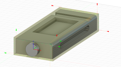

Curious if anyone could help me wit this: I am trying to machine a curved surface on a rotary axis:
The problem I keep running into is that the end mill stays "normal" to the rotation point of my 4th axis, not normal to the surface:
I should be able to do this with the machine I am using because it can do simultaneous 4 axis.
Said another way, the rotary can spin around a full 360 and the end mill can still move on XYZ, this isn't a machine/post that maps X or Y moves to rotary moves:

The only way I can get the toolpath to look like what I want is this:
However that requires changing the origin of the toolpath away from where this 2x4 is chucked up. I haven't physically run this path yet but I assume that it will not work.
Does anyone have any suggestions?

Aa far as I can tell moving the rotary axis doesn't work...  Check out these examples
I put 4 facing toolpaths on here so you can see where the 2x4 is, check out the rounded corner. it's working in that it's not digging into my part, but it's using the WCS origin for "normal" What ends up happening is the "side" of the bit is being used to create the curved surface. I'd have to a tiny tiny stepeover for that to even begin be effective.
Here's what happens when I change the rotary position in the toolpath setup, but leave the WCS alone:
That, for obvious reasons won't work.
There has to be a way to do this... Maybe I'm not using the right toolpath? I've tried just about everything to get this to work and I have't found anything.

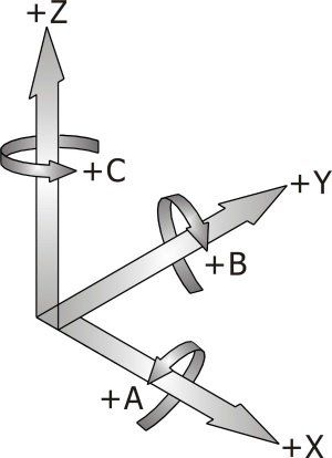

Maybe you could enlighten me (and others) as as to why. I had my post set to rotary table axis along Y+ My thinking was that my rotary (A) is pointing towards Y+.
Or to say another way, if you are near the 4 jaw chuck you'd have to move in a Y+ direction to get to the far end of the rotary. Perhaps Y- means that you want the "base" of the rotary near the lower side of Y?
I really appreciate you help!! This was a hard one to nail down!

I am not sure if there is a definite convention for rotary orientations.
The one I have seen on most machines uses this convention:
Note that B+ is clockwise looking in the +Y direction, but this is from the point of view of the tool not the workpiece.
so in your case if you Jog the rotary in the + direction looking in the y+ direction the rotary should turn counter clockwise

Interesting... That would explain why on routers I've seen both A and B used as the rotary axis. I'll have to dig into this a bit more. Thanks again for the advice!
