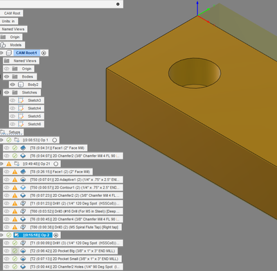

I have had this error on a number of occasions.  From what I can see, I have selected the same body for all the operations.  Not sure why sometime I get this error (see attached).

Because you selected Cam Components as your model. Select JUST the body and it works fine.
You also spot drill then interpolate the bores.

Thanks so much! Really appreciate it. I am still working on the last operation, just about to add a larger drilling operation before boring.
