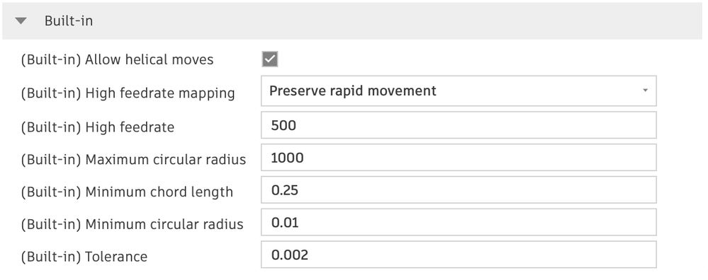

Had something similar where I specified no lead outs on a slotting toolpath. Fusion for no reason created little ~.0001" and ~.025" lead out rads though (tool was only Ø.055" so the tool would mill into the part). The toolpath Fusion displayed included the ~.0001" rads [which were impossible to see of course when not expecting any lead outs]. Fusion DID NOT display the ~.025" rads in the toolpath OR toolpath simulation [but they did come up when right clicking > show toolpath data]. Fusion posted both though lol. That was fun.
OP by chance did you play with any of these post settings?:
