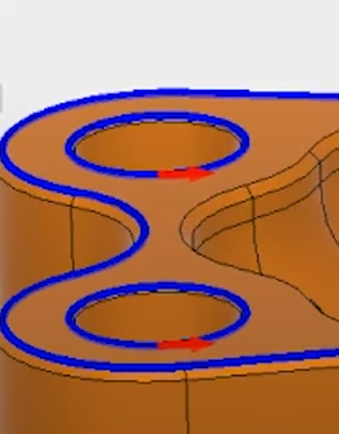

It seems like the trace operation is missing the "red arrow" directional function so the toolpath just blindly follow the countour with the center of the tool.
Screenshot from the Titan-9M video using the trace function for chamfering
Message 3 of 14
seth.madore
It sounds like you've still got Trace set to "Center" for it's compensation. Set it to "Left" or Right" for the arrow to appear as well as for Stock to Leave to have an effect

ole.alex
Thank you.
Your solution works, but unless "chamfer tip offset" has a value an "unexpected error" message appears.
Might be an idea to make this a little more intuitive by adding am actual error message that helps with the problem.
