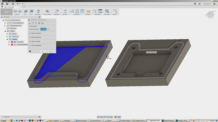

Take a look at the attached screen shot.  I'm trying to machine out the pocket.  I've selected the perimeter at the bottom of each of the pockets I want to mill.  Fusion recognizes it, but then will only draw a path to cut some weird pseudo triangular portion of it.

LibertyMachine
And what does the completed toolpath look like when you click "OK"?
Can you attach the .f3d file? File > Export > Save to local folder. Return to thread and attach the .f3d file in your reply

Sorry..thought I was uploading photos "the easy way".  See if these help.
This is one of quite a few components in an imaginary project.  Is there a way to export just this component?Selecting Bottom Perimeter of PocketSelecting Bottom Perimeter of PocketAlthough it shows the entire perimeter, it doesn't want to cut itAlthough it shows the entire perimeter, it doesn't want to cut itAgainAgainCreated ToolPathCreated ToolPath

LibertyMachine
Well, there certainly appears to be a bug going on here.
As a workaround, I'd suggest using 3D Pocket Clearing to remove the material, as that is "Model Aware"

LibertyMachine
In this case it's not something you did. I selected the feature a couple different ways and received the same results.
3D Pocket is super easy. Select your boundary, set your top and bottom heights and your max/min stepdown. It will see EVERYTHING inside of that boundary:

meletis.stathis
Hi @apostM2K9B,
The selection chain is not closed. Closing the contour will fix your pocket selection and the toolpath will be correct. My rough guess is that the model sketch has contour overlaps.
Open selection chainOpen selection chain
Close contourClose contour

apostM2K9B
Never thought of that.  The original drawing has a section that passes through the outer wall and would intersect with the perimeter.  Would that be a problem?
