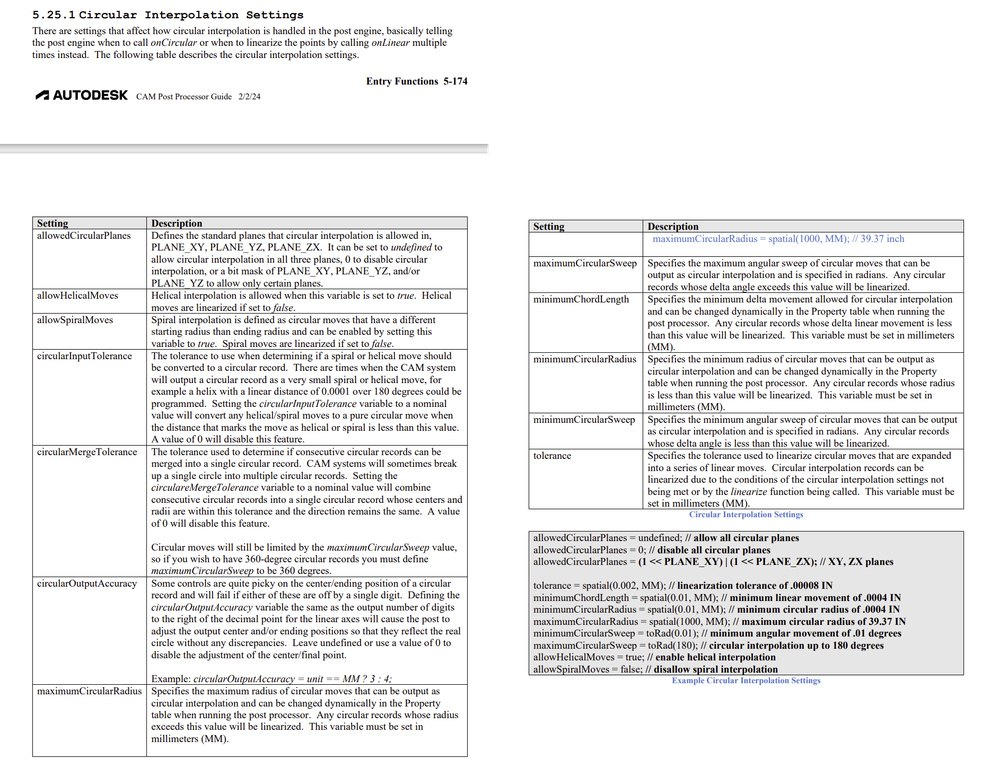

Got another problem. Noticed that bores are not perfectly round, checked machine parameters and machine arc tolerance is 1mm. Can I change it in post processor to generate less lines when milling bores?

andrea.amilo
Hello @DominikRek,
I am happy to learn that now the rotation head on your machine seems to work well.
If so, please click on the "Accept Solution" tab: it could help other Fusion users with the same machine kinematics.
Andrea Amilo
Senior Technical Consultant
Autodesk Knowledge Network | Fusion 360 Webinars | Autodesk Make
Message 19 of 21
andrea.amilo
Hello @DominikRek ,
the following code lines handle the arc configuration in your postprocessor:
This is a Post Processor Training Guide draft that explains the meaning of the circular parameters:
If you wish, you could disable all circular interpolation by setting the allowedCircularPlanes to 0.
I hope this could help you.
