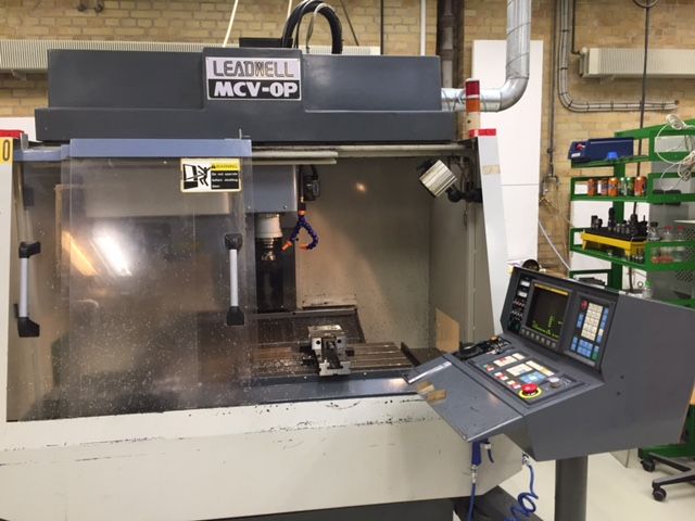

Please help us out with a working postprocessor for our mill Leadwell MCV-OP fittet with Fanuc O-M post. Model no. MCV-OP
We are located at Next Copenhagen, where there is no will nor help with Fusion. So I hope someone out there picks up on this.

The generic Fanuc post "should" work pretty much as is. I've got an '82 Matsurra and a 2015 Mori and they both use the fanuc post. Granted, I've tweaked it quite a bit, but mostly for looks and "feel"
Have you tried that post? And if so, did you get alarms or any issues? If so, please detail them in your reply.
The next best thing you can do is to simply attach a proven program that would showcase the majority of the G and M codes, such as arcs, feeds, tool calls, h and d offsets. Tapping cycles, anything funky with them?
EDIT:
MasterCam posts will be meaningless to us, as they are a format unique to MasterCam. Proven programs is where it's at for the best understanding.
.txt and .nc files are the allowed file attachments. (pdf, png, jpeg are also allowed)
