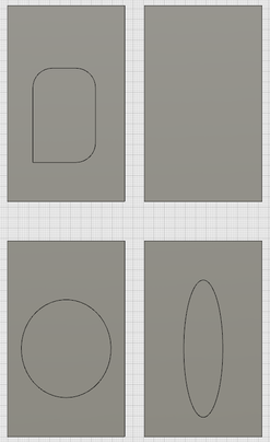

I am new to the topic of CAM and Post Processors but I have a general idea of how it is working, and I should say that I am doing cutting using a waterjet cutter. I used the default jet.cps file as a template to create a custom CPS-file primarily to change the syntax of the commenting.
But as I was working today I noticed that when using the post processor the circles and ellipses gets converted into lines (G1) in the NC-file which result in several hundred lines of code.
When I try to cut arcs it write code telling the machine where the starting coordinates and center coordinates are (G2). This way the cutter calculates the path to cut.
I don't know, but shouldn't it be able to do the same with circles and ellipses?
I hope the above description was understandable, otherwise just write a comment and I will try to explain it more in detail.
Attached NC-files of the 3 figures on the image.
Best Regards
Erik

Ellipse will always be small lines, given that's what they are always in reality. Other than that turn on  smoothing and it should shorten you code into something a little more normal and to your liking.

Thanks for the response. Where to I change the settings for smoothing?
I still don't get it for the circle. Shouldn't one be able to draw a circle from a single arc.
In that case, why do the post processor try to cut it into small lines?
- Erik

The smoothing option can be found in the 'passes' tab of each operation, enabling this should solve your problem.
Would it be possible to share a copy of your part so we can see what is happening here?

Thanks for the quick response.
I tried the smoothing and already at 0.01 mm i went from 400 lines to just above 100 lines of code with some arcs.
I even pushed to the next tick on 0.02 mm and it printed 60 lines of code and almost all of it where arcs.
After that I tried to cut a new circle and know i suddently worked and cut the circle in two arcs, so I don't know what caused the problem in the first place.
I also cut the circle in half to make sure it would do the same and it did.
I attached the model (Didn't know if that was what you where asking for by referring to 'part') and the nc-files of the ellipse with smoothing turned on.
- Erik
