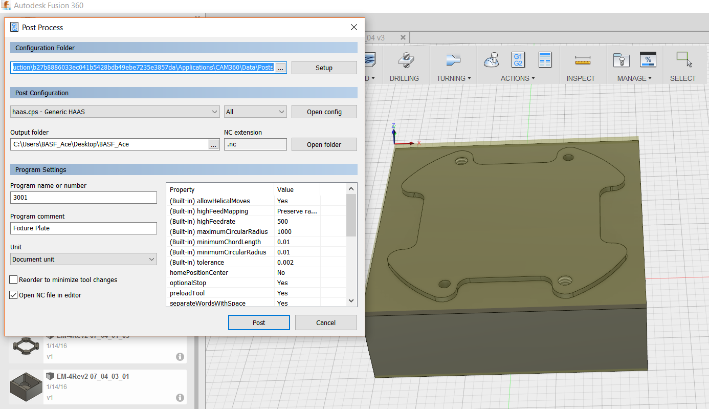

Hello everyone,
So I'm putting together my first Fusion program and I noticed something odd in the code.
If you look at Line 17 it reads T2, which is so weird, because T1 was just called up, not T2. Even the Height offset corresponds to T1 in line 16. When I scroll down to the next tool path the same thing happens: the code reads "T1" in the line after T2's height offset is set.
Can someone shed some light as to whats going on here?
I have never noticed anything like this happening with MasterCam.
I'm using the Generic HAAS configuration.
SettingsWeirdness
Weirdness 2

Steinwerks
It's a preload command. It stages the next tool if you have a sidemount ATC. If not, turn the option off in the post options screen.
