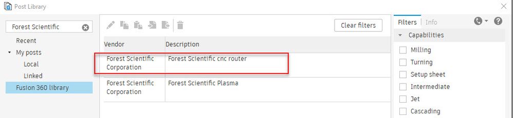

Hello im nikko and ive been using fusion 360 with my Forest Scientific cnc router. when i went to post my part today the Forest Scientific cnc router post was missing. im not sure if this is due to a recent update pushed or if its something on my end.
if any one could  help me with this id greatly appreciate it!

If you do not see it in the Post Processor list in the application, which I do, then you can go to the Autodesk Post Processor Library online and download it.
