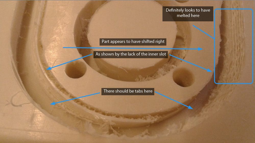

The Cam tab has 4 process's, 3 cut fine but on the 4th it starts to drift on the y axis.
1. A slot around the outer edge.(2mm endmill)
2. 4 Holes for magnets.(6mm endmill)
3. 2 large holes. (6mm endmill)
4. The outer shape. (6mm endmill and Here's the problem)
It appears to drift upwards on the y axis by about 1mm on each pass around the outer edge. I have ruled out backlash and am 99% sure that its not missing steps. (If it is missing steps its doing it in exactly the same places, Everytime I run the code and only on the last toolpath.... VERY unlikey) It is as if it happens gradually over the course of one time around, There is at no point a recognizable "step". What I dont understand is why it can cut everything else fine but not the outside cut, In my opinion it has to be a software/ gcode problem.
I have also tried a few different things like:
- Plunge into matirial and ramp into material
- With and without lead-in and lead-out.
- Changing the cutting feed rate.
.... But the result was the same everytime.
I must admit that fusion can do alot more than what I understand sometimes, maybe I have missed something but I am currently at a loss and don't know what else I could try.???? Any help would be Greatly appreciated!
Here is a link to the model im trying to cut: http://a360.co/2dtOIje
... And I have attached some pictures to show the result after cutting (I didn't let it run until the end as i could see it wasn't correct)

I just want to ask a really silly question... Are you sure the spindle is running in the right direction? It looks like the material is being pushed or melted? What is the material by the way? Is that material Polypropylene? Cause that stuff does not like to be machined at all. And you would need decent clamps just to hold it. Is it possible the spindle rpm is too fast? I just don't see evidence of clean cuts and chips. Looking at the attached model in A360 the CAM tool path plays like it should. I can't open it in Fusion from work. It looks like the part is being moved like it is resisting cutting.

Yes spindle is running correctly, the matirial is Pom-c plastic. Its a bit of a pain to cut, but im sure that has nothing to do with it as the rest cuts fine.

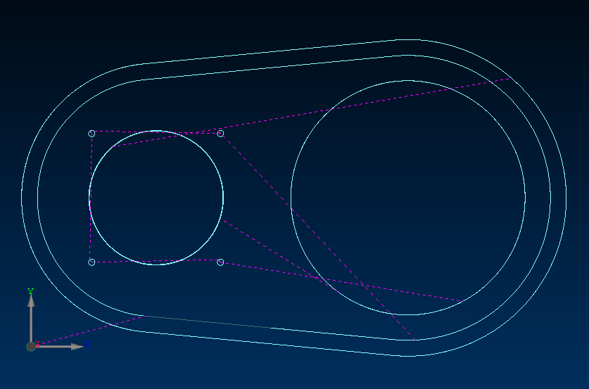

Here's a backplot of your code and there's no problem there. What happens if you go back to one of the holes, can you jog to where they should be and see if the machine setup is still correct.
You can download a good backplotter here NC Corretor.

G code looks fine on my side also, but looks like you are getting some part movement or vibration as it's being cut, also appears that you have lost your tabs
LRjVVbC
Also, I would recommend doing boring operations instead of pockets for the 4 smaller holes. The 1mm stepdown is pretty shallow for a 6mm cutter also, You could likely bump that up to 3mm even for a full WOC.
The melted plastic is on the side where the material to cut is thinnest, but also where it needs to evacuate from, so every revolution a chip is being rubbed up against that exterior wall causing heat and friction, which is probably the source of the melting. I think you should decrease the spindle speed so that it creates bigger chips which should help remove some of the heat (plastic is insulting so it won't absorb as much heat as a metal chip). I think you just need to be a little more aggressive with the cutting to reduce the heat some. The fact that it is insulting also means more heat is going to stay in the endmill, causing it to just melt through the plastic and displace it on the outer edge instead of truly cutting the material.
