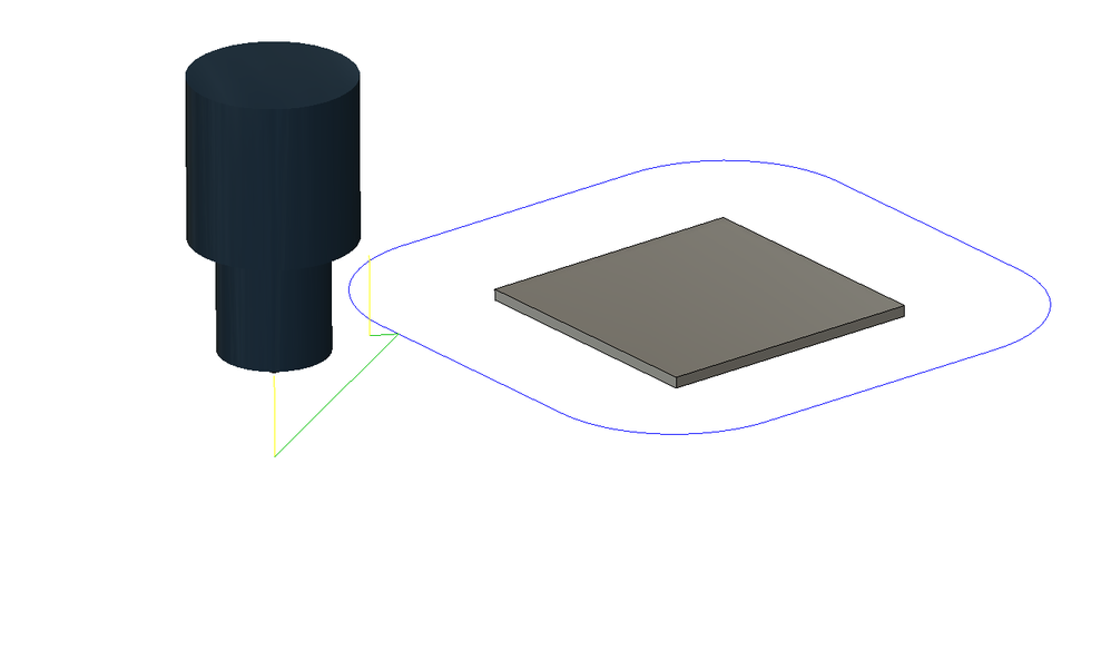

Ive noticed that adjusting the kerf width on a plasma cutter tool has no effect on the cut. All of my cuts appear to be a couple of millimeters too tight which is really frustrating!
I've adjusted the kerf width all the way up to 20mm to see if that has any effect, it only seems to adjust the lead in and lead out length. In Simulation mode, everything looks as I would expect, which leads me to belive there is something wrong with my post processor? I'm using the mach3 plasma processor downloaded from the autodesk website.

Sorry for the delay in my reply. I have been playing around with it today and it appears that the G Code exported runs the toolpath directly on top of the perimiter regardless of what the simulation is showin. I have uploaded a screen shot where I have over exagerated the kerf to 50mm to make the issue clearer.

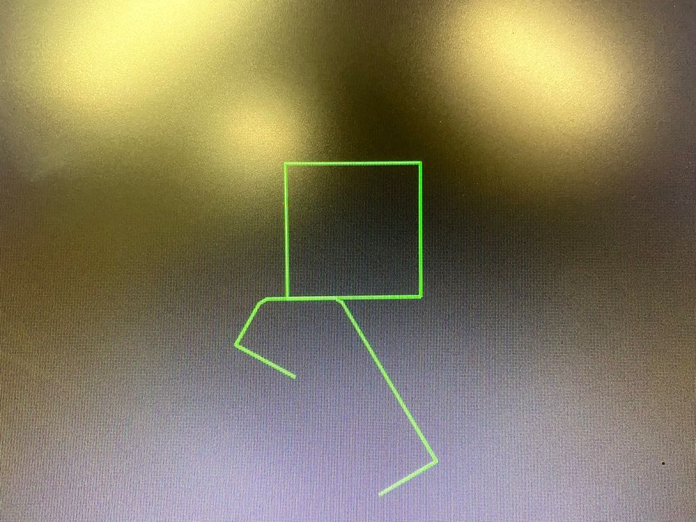

I have also attached a photograph of the cut path in Mach3 - As you can see the lead in and lead out are compensating for the larger kerf.
IMG_2665.jpgBelow is the G Code that is outputted from this setup:

When the compensation type is set to In control then the toolpath does not calculate the kerf with from the tool kerf in fusion istead it posts G41 in the code where you can give the offset value in the machine.
So if you want to calculate the toolpath including the tool kerf in fusion then you need to set it to In computer the you can see the difference in the codes with respect to the tool kerf dia

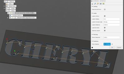

I am having similar issues as the original poster.  My issue is with a post for a ShopSabre Plasma table that uses a WinCNC post and Fusion 360 Manufacture tool paths.  In my situation, it doesn't accept cutting paths in tight areas and no matter what I do it won't generate a path.  I have checked to see if the path should fit and from basic measurements and a little math is should work.  I'm also finding that when I remove the lead in - lead out from my tool path Fusion 360 seems to put it in anyway.
Things I've tried:
1. altering the geometery by exploding the text and changing the geometry of the text to give what I though would be enough space to build a toolpath.
2. Removing the lead in... mentioned above.
3. changing cutter compensation in the tool description to .oo5 in.
I have also exported the text  from Fusion 360 and imported into Enroute, which I used to apply .100 in kerf and generate G code with cutter compensation.  So, I'm guessing the geometry is correct and that there's something messed up with how Fusion 360 manufacture generates tool paths for plasma cutters.

What you may be seeing after removing the Lead In/Out could be the "Pierce Clearance", this value is added to the Lead In/Out so there is still a move in to the cut.

That`s OK, I looked at your file and it does appear to be the "Pierce Clearance" value that is too high, without changing any of your other settings I found that with your Lead In/Out of 0.045in that a "Pierce Clearance of 0.08in or less will allow all the toolpaths to generate correctly. So, you can adjust both the Lead In/Out and Pierce Clearance values to suit what you need to do, they are added together. Updated file attached for you as an example.
