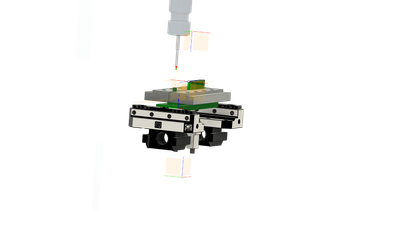

ViceOP2_Gernadi v3.pngI have a similar issue
I do OP 1 in a vice setup, but for op 2 we need to add soft jaws, flip and turn 90 degree in a 1 vice setup.
In the past you could export as a STL (lousy format) but that was removed when we got the manufacturing setup function that does not work because we cannot import parts into it and I don't want 50 vices in the design files for our machines.
I cannot come up with a way to have the vice, soft jaws, remaining stock transferred to another setup.
Any examples that transfers stock into soft jaws?
How do we flip and turn this into soft jaws?

jagSJMV8
Is that how you were thinking, and are you then moving the inverted vice every time??
Message 7 of 13
seth.madore
Assign each vise to the correct Setup and then when you activate the Setup it will only display the correct vise and part orientation for the Setup.
If you want to share your file here, I'm happy to take a look at how far you've made it.
