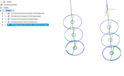

In this project the last operation is supposed to enlarge the existing hole from 3.5 to 4mm. If the compensation type is "in computer", all looks good (a). However, if compensation type is "in control" only the first stepdown is generated (b).
I don't understand why. I know that sometimes in control toolpaths can't be generated for a given hole/tool diameter ratio. But why would it now compute for one stepdown and not for the rest?

Remove the Vertical Lead-in Radius. You're getting too close to the wall and it detects a gouge. Either that, or put your Sweep Angle to 45 degrees. Shown with no vertical lead radius:

The problem is that what I see (in both toolpath preview and simulation) is
a toolpath that does not match my parameters. Even if I make small changes
and I gradually improve it the right direction, the improvement will not be
reflected by the toolpath and I will have no idea that I made it better or
worse. Unless I fix the problem right on, all my changes are dropped just
like the original input.
That is why I would rather prefer the toolpath to generate "as designed,
with problems" (with collisions signaled clearly in simulation) and the
"improve, with warnings" to be an option _after_ I've seen my path.
ltomuta
Reducing the lead-in distance worked, thanks. But how does that value's impact change with Z?
Changing the angle did not help and, as mentioned above, there was no indication of any progress/improvement with the change. Did the problem improve with 45 or was made worse? Is it worth trying a 20 degrees angle or a 120 one?
