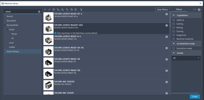

I recently purchase an Okuma M460V-5ax machine. I was wondering if anyone had a working post for a full 5th axis. I've been having troubles getting help on this issue and thought maybe someone would be kind enough to share.
Thanks.
RJ

What specific issues are you having with the posts you have tried?
You Should be able to use the latest Autodesk Okuma Post along with the Machine from the Fusion library

I was not using the machine. when adding a machine does it changes the post? or post library?
a.laasW8M6T
Hi
By default the Machine from the Fusion Library uses the Standard Fusion Okuma Post Processor.(You can select any post you want in the machine definition though)
You generally have to use a Machine Definition in Fusion to use Multi axis machines as it defines the Machines rotary axis configuration
