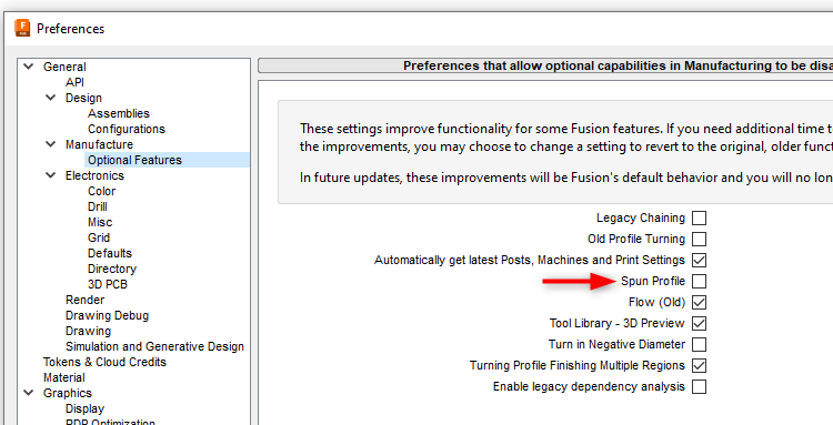

Hmm. I'm also seeing the toolpath generate properly, both with and without the new Spun Profile enabled. Can you check to see which one you're using? It's in Preferences > Optional Features:

It was enabled in preferences. But when I disable it, it generates fine but only allows the front fillet to be machined.
When I create another simple turning process in a new model it works fine. It just seems to be this model I'm having trouble with.
