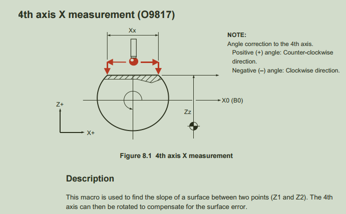

Is it possible to implement 'Angle along Z axis' in fusion, just like it's possible with X and Y.
Attached is a part of the Renishaw inspection plus manual that describes this feature

I'm guessing you want to adjust tilt on B axis to put a feature into an aligned Z axis?
Most angle measurements are just under 1" (25mm) in touch distance, how to get a ~Z -1.0 touch without stemming out the stylus or worse crashing the probe body into a part destroying it I think would be complex and that specific Renishaw sequence supports X / Y not Z probably because of that
Any approach would have to be a static negative angle and severely limit the sequence because of the shrouded nature of the Z angle measure that is not present in X / Y routines. I have a 150mm stylus on my probe to align WCS with my 3d printed metal parts and still have the most issues with Z clearance and not shanking out on the probe stem

DarthBane55
There is a Renishaw cycle for Z, for this exact purpose.  Fusion doesn't support it.  I have added the function in my post by using some unused check boxes, it's a bit of post work, but it works.  The drawback is that you can't see it in fusion, because it does not exist.  I use Z surface probing cycle, and with a few options set right, I output the B-axis alignment cycle.  It is all in my post, and it works flawlessly on the machine.

I was considering doing the same thing !
@rengfx  here is the probing cycle we have for our DVF5000 . P9818 does the same thing but in the Y axis if you were to have an A axis instead of B.  However , this does require having Renishaw's Inspection plus software i believe .
